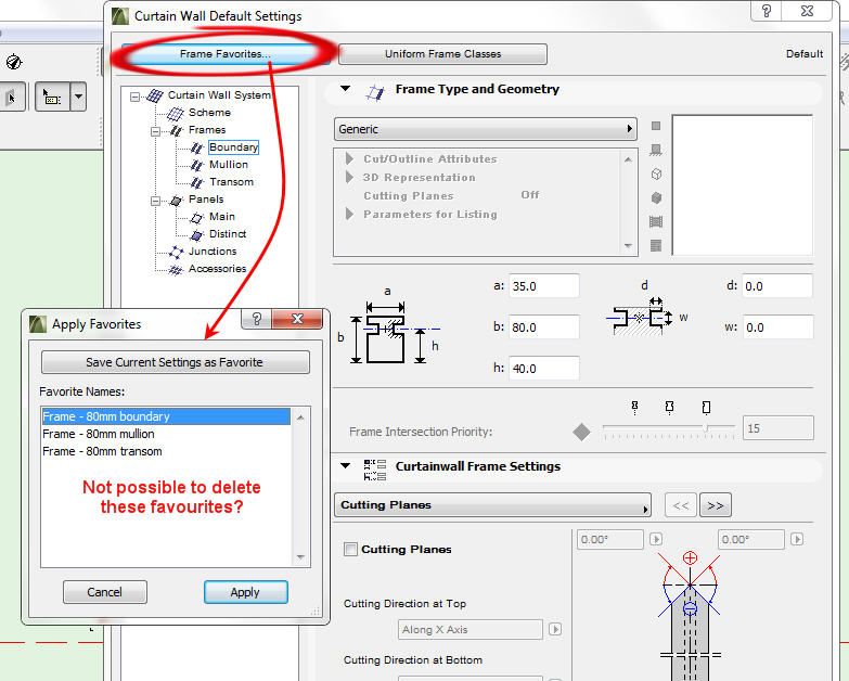

How do you delete a curtain wall component favourite?
How do you delete the favourites for curtain wall components?
I can delete the actual complete curtain wall favourites in the favourites dialogue box but the componenets (frames, panels, junctions, etc.) don't show there.
In the curtain wall settings you can add new favourites but there is no way to delete them.
I am guessing I can do a 'New & Reset All' and hopefuly that will have no favourites.
Then I can merge back in (one by one!!!) each of my favourites I want to keep from my template - excluding the curtain wall component ones, but this seems like an unecessarily long way to do it just to delete 6 or 8 favourites.
We really need better control of the favourites.

Select the Curtain Wall and click Edit in 3D.
While you are in editing mode you will see the Favorites of its components in the Favorites Palette and you can delete them.
Thanks Laszlo I hadn't noticed that.
Probably because I never use the curtain wall.
These are old favourites I must have made when playing around with it when the curtain wall tool was new.
Works perfectly.
