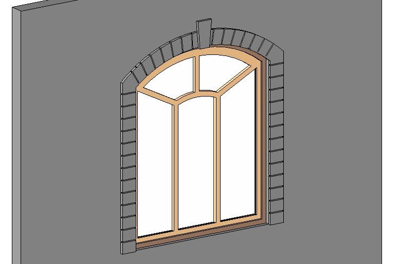

How i can make like this frame stone very quickly ?
2011-10-22
06:20 PM
Hi every one
, i want to make like this frame stone that has division very quickly what do you suggest to me to achieve very fast with ability to modify on division if needed

As a "Complex profile"
The thickness of the stone would be the length of beam or wall.
