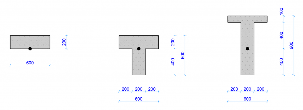

The shape of the beam can be defined with the following three cross section profiles:

Select the Beam icon at Use with. Select the Reinforced Concrete - Prefab fill pattern and draw a Tee profile according to the screenshot below.
The origin of the profile must be in the middle of the web, 400mm above the most bottom edge of the fill.
Enable Width/Height Stretch and arrange the Horizontal/Vertical Stretch Zones according to the image below. The bottom of the vertical stretch zone (horizontal dashed lines) must be at the profile origin, the top at the upper edge of the profile. The horizontal stretch zone (vertical dashed lines) spans between the left and the right end of the profile.
Add the Flange Thickness and Web Thickness offset modifiers. The default size must be 200mm for both.
Arrange Nominal Width/Height dimensions according to the image. The first must be 600mm, while the second has to be 900mm.Save the complex profile.

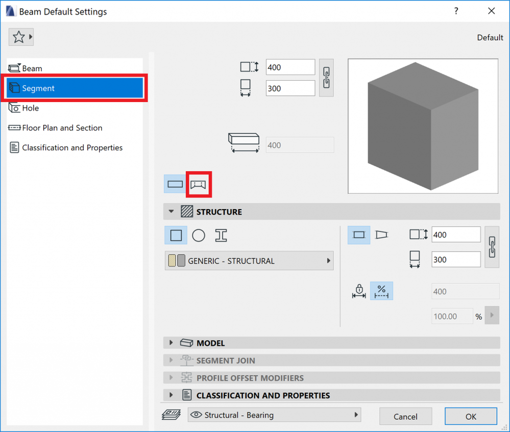

Double-click on the Beam Tool on the Toolbox. The renewed Beam Default Settings dialog will appear on your screen. In ARCHICAD 23 the Beam and the Column Tools became hierarchical system elements therefore the user interface became also hierarchical. There are separate pages for Beam, Segment, Hole, Floor Plan and Section, Classification and Properties.

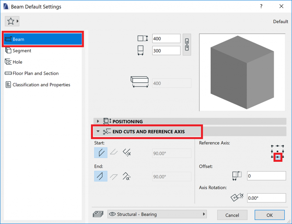

Select the Beam page, navigate to the End Cuts and Reference Axis panel and select the bottom-center option at Reference Axis.
Navigate to the Segment page and select the Multi-Segmented option. The beam is now consisted of a single segment only.

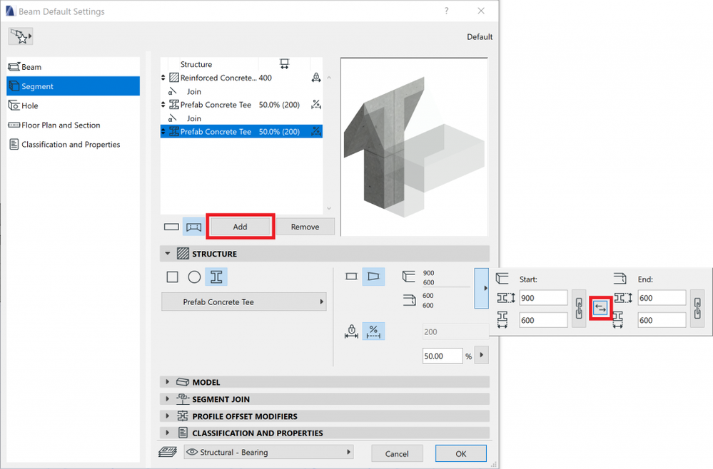

Selecting the second segment and clicking on the Add button will create a new segment by duplicating the selected one. The double-pitch beam is symmetric, therefore some of dimension must be exchanged between the start and the end of the new segment.
Keep the third segment selected, open the Structure panel, click on the small arrow on the right side and click on Swap Start and End Sizes. This will mirror the geometry by swapping the settings.

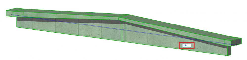

Edit Mode makes it possible to select individual segments by simply clicking on them. The selected segment will be highlighted in green. You can enter Edit Mode by opening a 3D view, selecting a beam and clicking on Edit.

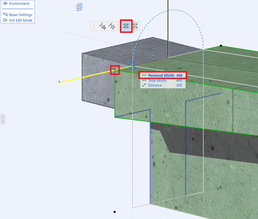

Let’s start with selecting the rectangular segment on the left. After selection, please click on one of the hotspots. Select the Stretch cross-section width symmetrically option (second from left) on the appearing pet-palette and change the values of the Nominal Width from 600mm to 400mm.
Repeat these steps with the second, sloping segment with the Tee profile, but this time choose the Stretch cross-section nominal width symmetrically option (third from left).
Continue with adjusting the Web Thickness, which is controlled by an offset modifier defined in the Complex Profile. Edges controlled by offset modifiers are highlighted in blue, click on one of the vertical edges of the web, select Offset edge(s) option (first from left) on the pet palette and simply drag it and change the values of the Web Thickness from 200mm to 150mm.
The Nominal Width and the Web Thickness must be modified at both ends of the segment must be modified as it has a tapered geometry.

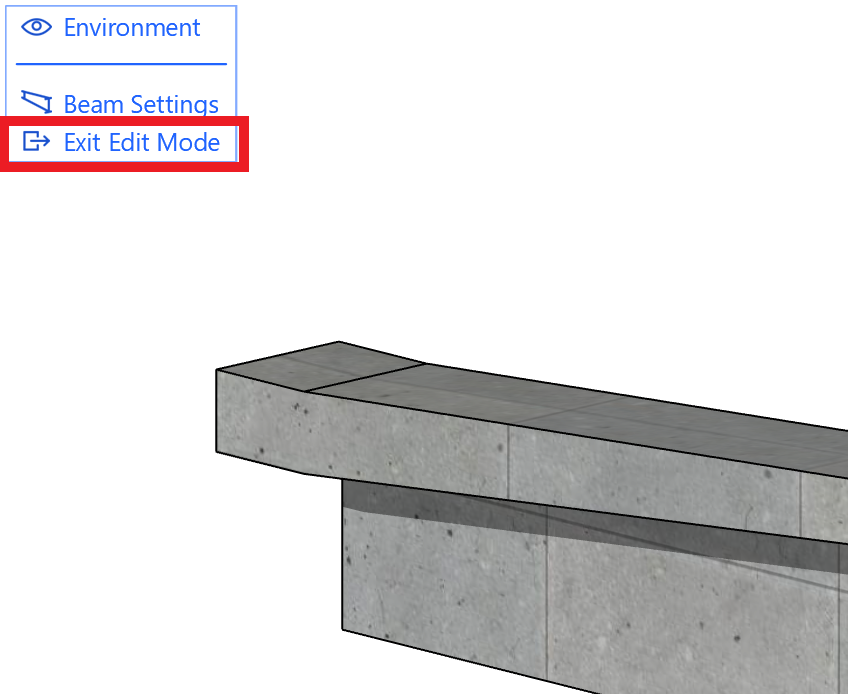

After finishing the change select Exit Edit Mode.
The modified double-pitch beam looks like this in 3D after leaving the Edit Mode.
