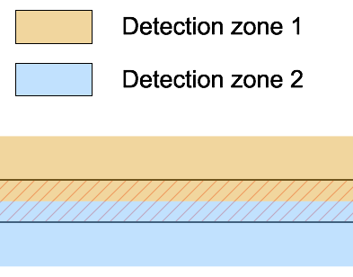

In ARCHICAD 17 a wall has two detection zones.

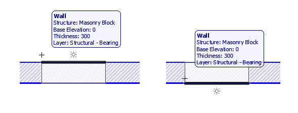

When the user selects the Door/Window tool and moves the cursor close to a wall (closer than 15 pixel) then the wall is highlighted, and the feedback about the wallhole and the reveal side appears. A small sun indicates the reveal side, that is the outside.
Three Geometry Methods are available (in ARCHICAD16 only two: centre or side) before and during the input: center, side1, side2. In certain cases the reveal side must be changed and it is available by pressing the TAB key. After the first click the feedback of the opening appears and the selection of the Opening Direction and Orientation becomes available. Moving the cursor around the wall indicates the highlight of the opening's final position.

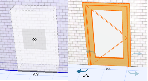

Opening placement in 3D
In 3D the cursor must be positioned on a wall surface where the opening will be placed. The first click defines the position of the opening, the second click defines the Opening Direction and Orientation. The Reveal side can be changed with the TAB key.
Flip command is not available with certain openings e.g Historic Windows. For these openings the flip option is not eligible due to the opening's structure. The rule for the openings accessories is that the reveal side=outside, the users can associate to it from the sun sign. Certain features (casing, material, masonry arch, etc) are linked to the reveal side. When we define the reveal side during the input, the casing and other structures follow this rule. The remaining Flip command changes only the position of the door leaf. Materials, grill and other features stay at the original position.

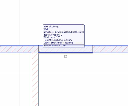

Overlapping Detection Zones
In case if the cursor is in the position of overlapping detection zones, the highlight shows which is the edited wall. Also the Info Tag displays the properties of the highlighted wall. Switching between the walls is possible with TAB key.
