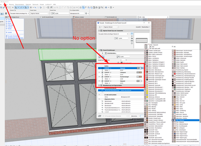

Is it possible to ascribe the function to the layers of the multilayer panel of the curtain wall? Now, it's known that the latest version of ArchiCAD has a bug that prevents one even from chanign the materials of the multilayered panels:

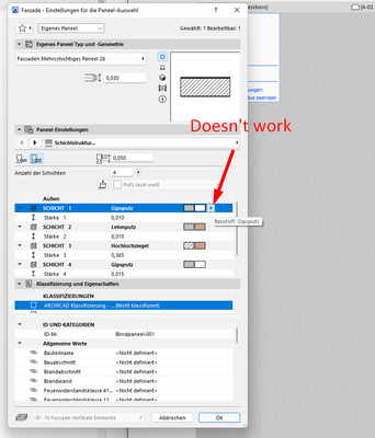

But, even if the same thing is performed in the previous version, it seems that there is still no option of setting up the function:

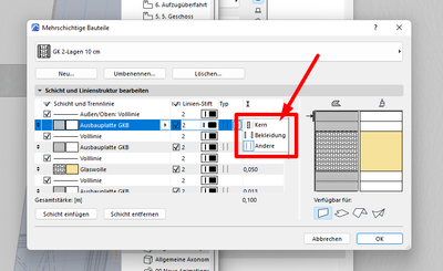

such as this one, in the settings of the multilayered constructions:
1 REPLY 1
That Curtain Wall panel is a Library Part, which means you would have to modify its GDL script and interface script so you can set a Skin Type for the individual Composite Skins, plus to make it able to respond to changes in Partial Structure Settings changes. Requires relatively advanced GDL skills I believe.
