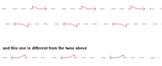

rocorona
One can have several needs, that seems addressed by some software. I know ArchiCAD has more than 500 commands, and AutoCAD a lot more. Anyway I doubt there is one to choose to "reverse" the linetype horizontally or vertically. Sometime it can matter.
I'd keep it simple, and duplicate the linetype, with reversed elements.
