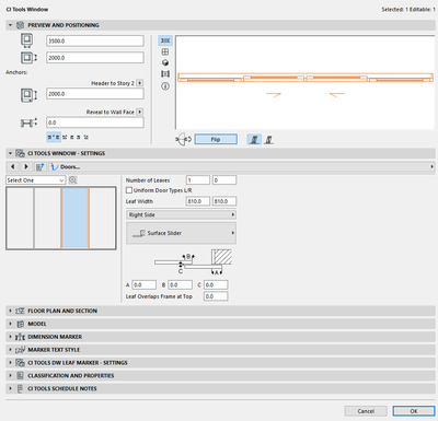

Can someone please tell me how to change the direction of a surface slider?
I want the two center panels to be opening away from each other.
I am really struggling with the CI tools windows and doors. I find them to be needlessly and overly complicated. There seems to be a thousand options for any concievable configuration, but something as simple as changing the direction of a slider I cannot figure out. I'm sure it's a simple fix but I've spent an embarassing amount of time on this and cannot find the solution.
Thank you

Is this not just a symbolic issue with the arrows showing direction to close rather than open? Is the 2D opening width set to zero? I remember one door, not CI, that was showed direction to closed if it was shown slightly open...
Ling.
