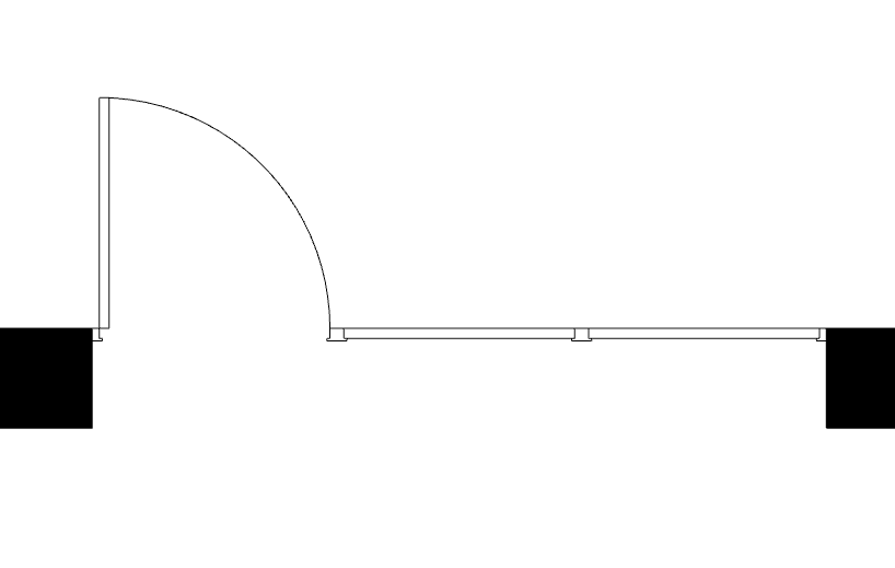

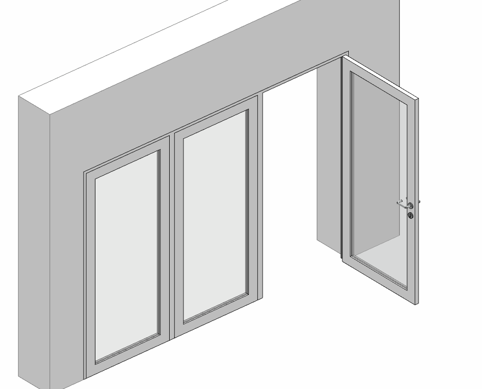

Hi! How to create custom door ? like that one below:
As you can see it has a door at right side and 2 frame divisions on the left side.
Can I easily edit or create any custom door layout? Maybe somehow rearrange existing elements and not create those totally from scratch.

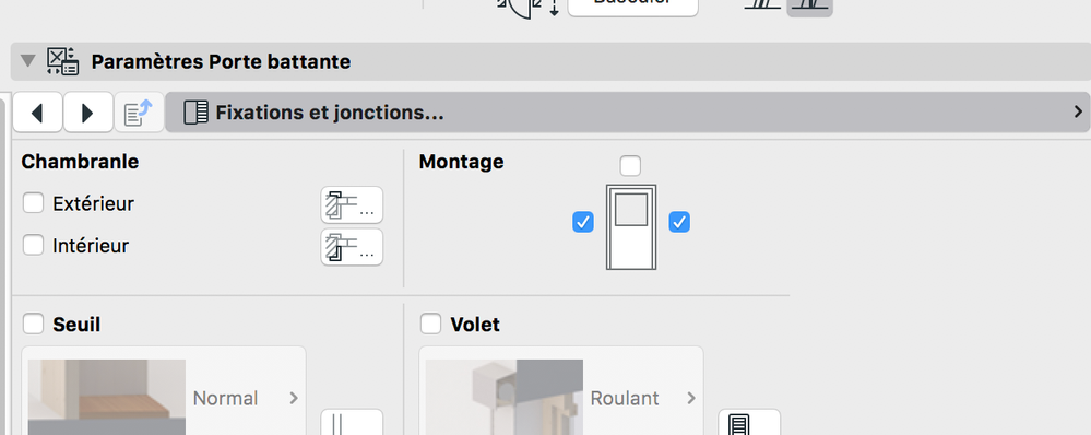

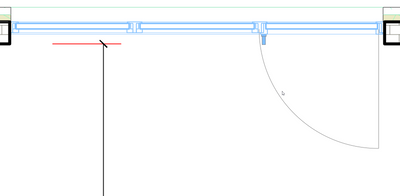

You are able to model 3 doors and hide lines between. There is 3 pictures below to show you how to do.
Using another tool than door is not a cheat. You are able to model a ceiling with the slab tool. 😉

Aha ok, so no chance to modify a door to have such door like on picture, understand.
Thanks for help.
Not unless you are a wizard at GDL scripting.
