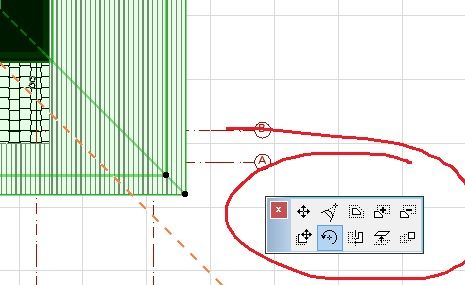

I was using two monitors and left this menu (selection menu or smth becausause I don't know how to call it) on second display. When I disconected second monitor selection, menu didn't return to main display. Somehow Archicad remembers second display even it is not conected.
Please advice how to return this menu to the main screen without conecting second monitor back. Or maybe you can tell me how call this type of menu?

It is called the Pet Palette.
In the Work Environment in the section for "Dialogue boxes and Palettes' there is an option to 'Follow cursor' or 'Jump to preferred location'.
Try changing that to 'Follow Cursor'.
Or you could just try reapplying the standard work environment profile.
You will be better of to save one Work Environment Profile for a single monitor setup and another for a two monitor setup.
Then you can apply which ever one you need when you need it.
