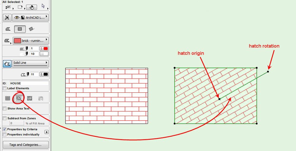

See screenshot.
Detail hatch creates some sort of directional vector at a base point located very far from the detail. What is going on here? Moving the entire detail requires zooming way out to locate and select the hatch item along with this vector point (not sure of the technical terms for this item).
Explanation would be helpful...

Its correct name is 'Editable Fill Handle' and is part of the construction methods for fills.
I have no idea why it is so far away other than it must have either been moved there or the fill was drawn with this construction method turned on so you draw the fill perimeter and then click to place the EFH - this last click being far away.
Either way you can select the fill and move this handle closer.
Grab it at the end with the cross and move the line (using the sub-element move option in the pet palette - the position of the cross will be the origin of the hatch pattern.
If you grab the other end of the line it will simply rotate and the angle of the hatch pattern will rotate with it.
Alternatively you can select the fill and turn this construction method off and the line will disappear.
The angle and rotation of you hatch may change.
If it does then turn it back on but now it will be in the centre of your fill.
Now move and rotate it to suit your needs.

I might be missing something here but the problem you first showed has nothing to do with the fill orientation in the building materials.
The editable fill handle is part of the fill tool and does not appear in Building Materials or composites using those BMs.
The first image you showed has a hatched fill in a detail.
You will have to open the source view of that detail to edit the fill (it looks like you were showing it on a layout page).
The attached image shows the Editable Fill Handle.
