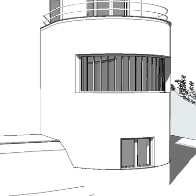

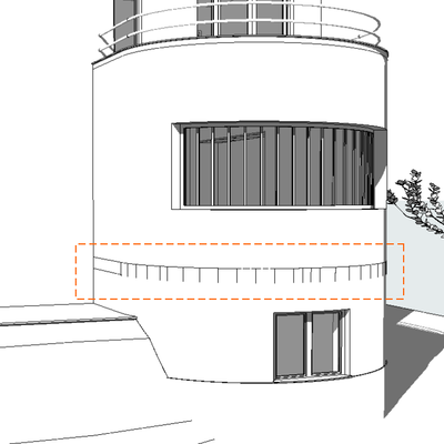

When modeling curved walls and slabs, their edges must align perfectly for a tidy, precise result. If the wall and slab use different curve segmentation settings, their intersections may not match, which can result in small gaps or overlaps in the model.
Challenge: slab passing through the facade finishChallenge: slab passing through the facade finish

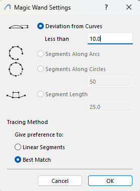

  1. Use the Magic Wand for faster tracing (optional)
    • Instead of manual tracing, use the Magic Wand with the “Best Match” setting.
    • Go to Design menu > Magic Wand Settings.
    • Set matching Method to Best Match, activate the Slab tool, hover over the wall edge, press Spacebar to trace.
  1. Check the Reference Line
  • Match the Slab’s Edge with the Wall’s Reference Line, making sure both the wall and the slab have the same number of segments along the curve. This will guarantee accurate alignment.
