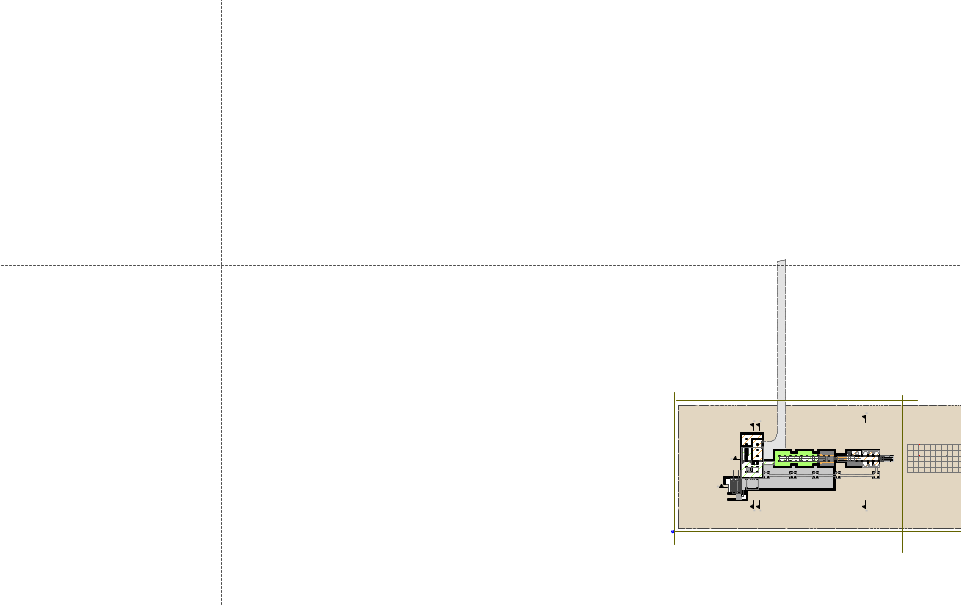

I inadvertently messed up some of my settings while trying to fix another setting and ended up getting dashed crosshairs that move across the screen with the point of my cursor. I really don't want them there and can't figure out what they are called and how to change the setting. Help!? I'm sure it is something ridiculously simple. I'm using the Student Version of ArchiCad 14. Thanks! (screenshot included)

If you have the ruler up you can right click on it and turn off "Cursor Projection".
If ruler is not showing, go to View > Ruler to turn ruler on, then do step above.

If you don't already have the ruler around the top and left of your working window (eg. floor plan window), then go to View> Ruler.
Then you can right click on the ruler and uncheck 'Cursor Projection'.

Genius, THANK YOU!
