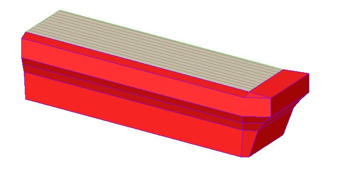

Your poor builder is going to have exactly the same problem out on site.
You are trying to mitre 2 angles at the same time witch would be very difficult to work out the exact mitre angle.
You need a 45° vertical cut for the corner but a non vertical mitre for the roof slope.
Really you need to mitre around the corner first with a horizontal profile and then mitre that to the profile running up the roof slope.
There is a good post here somewhere explaining it - I will try to find it.
It seems you had the same problem some years ago.
http://archicad-talk.graphisoft.com/viewtopic.php?p=163893
In there I found a link to this post - which I think is the one I was thinking of - but there may be another I can't find.
The last post on the first page illustrates the problem pretty well.
http://archicad-talk.graphisoft.com/viewtopic.php?t=9370

What I would do is this.
Place the profile along the front and wrap around the end (horizontally) - both profiles in the same layer so they trim automatically.
Place the raking beam on the side in a different layer with a different layer intersection priority number so it won't trim automatically.
In an elevation from the end determine the intersection angle or the roof and horizontal profiles.
Place a zero thickness roof at this angle from the top back edge of your profile.
SEO the horizontal profile to this roof with downward extrusion and SEO the sloping profile to this roof with upward extrusion.
And the end result (after hiding the layer for the SEO roof).

So now I've had to resort to a "hideous morph" object to cleanup at the corner.
GEEEEZZZ.....I wish I could make this thing work.
If only the two profiles would cleanup as they need to. Then I would have to use that morph object and have those extra diagonal lines in elevation.

You can edit the edges of the morph to make them hidden - make sure you use the sub-element selection to get just the lines you want.
There was no morph at all in the method I showed.
Exactly the same profile used as a beam.
The hardest part was placing the roof at the correct angle for the SEOs.

You seem quite upset that ArchiCAD can't easily draw something that defies basic geometry, and is technically unbuildable as you're trying to do it. You have several options:
1) Give the roof a square-cut end, rather than a plumb cut. This will let you wrap the profile exactly.
2) Use a slightly stretched profile for the vertical crown molding height, which will match the sloped crown's plumb height. Not perfect, but about the best you can do with a vertical fascia.
