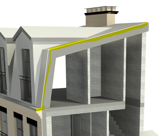

How to make this roof?
Hello everyone. Total beginner here. Just started with Archicad. Few years with Revit before.
What would be the process of making this kind of roof in Archicad?
roof
Thank you.

Hmooslechner
shells
Just turn off the german sound..
https://www.youtube.com/watch?v=SNBXgHf2j38
gudzius
after your "shells" i found this:
https://www.youtube.com/watch?v=fpCW6DoZzR0
thank you very much.
You can do this with standard roofs as well.
Just look at the 'Multi-plane Geometry'.
You can have multiple pitches in the one roof.
