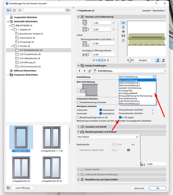

I can't be sure as it will depend on how the complex profile wall was constructed in the profile manager. Are the two separate parts physically split in to two separate fills in the complex profile or doe the face have a node and the surface below the node displayed as facing brick and above the node as render? have you tried turning the finishes in the Wall Closer section of the parameters window for the Window and then tick the 'Show in 3D' option?

The profile was created as a number of separate elements, with different functions. Thus, what is supposed to be a finish is listed as a finish, and what is supposed to be the core is listed as a core. Hereby I attach the file with the complex profile of the wall in question. You may open it via options/attributes/attribute manager/import.
As to the window, I tried all the options, but non of them yielded the desired effect. I ticked the "show in 3d" in all the cases:

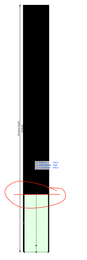

Right, what you need to do is split the core fill you have created at the same level vertically as the finish material and assign the same building material to that section of core as the finished face.
You then need to open the wall properties dialogue and turn off the wall edge surface override.
I didn't import your surfaces or fill patterns so they are appearing solid black on my screenshots where the surfaces and fills didn't exist but hopefully that will fix your issue. you may have to recreate your modifiers once you split the core.

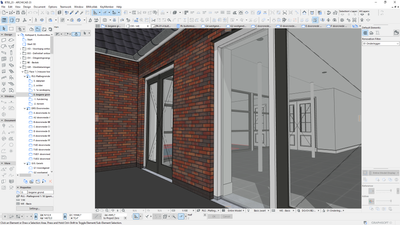

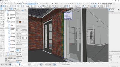

Erwin Edel
Rockstar
I fake this with a column on either side with the same building material. It will clean up automatically with the wall. If you set a custom origin for your textures, you do need to set the same origin for the columns though.
Is this ideal? No. But fixing every single door and window object in your library is going to be a huge chore and after the next library update, you're back to square one... either you use the new library (and fix it) or stick with outdated library.
In these screenshots if you look carefully you can see that the top of the door reveal / recess thingy is still showing the grey bricks. It didn't bother me enough in the artist impressions to fix that one with a beam or something. (it is almost nearly fully obscured by a steel lintel)
