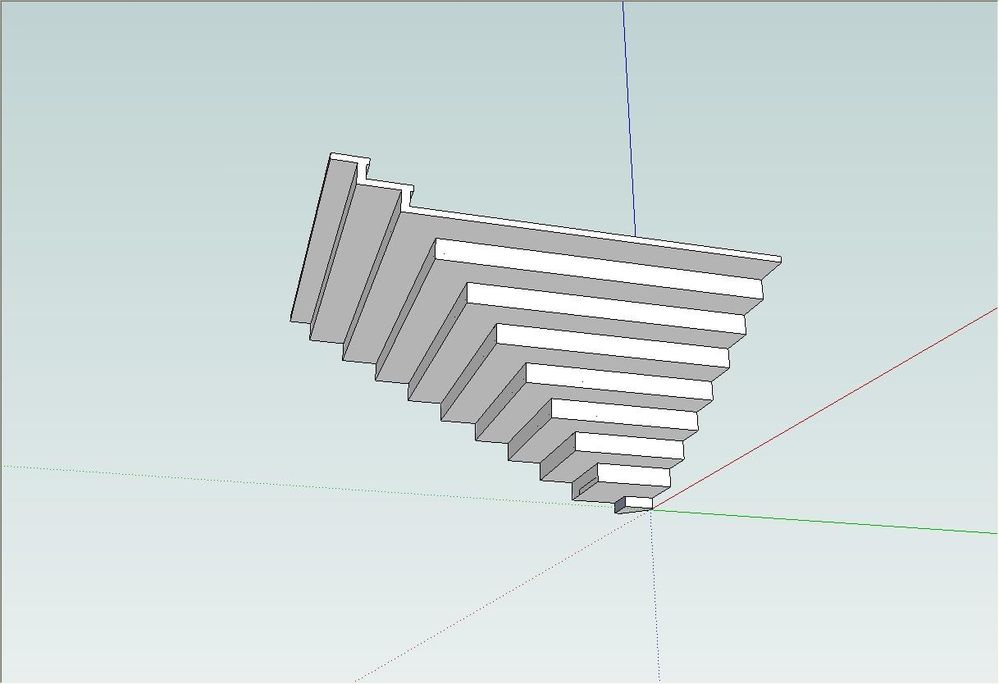

How to model this in ac. I can easily do that in sketchup but how to do that in ac ???

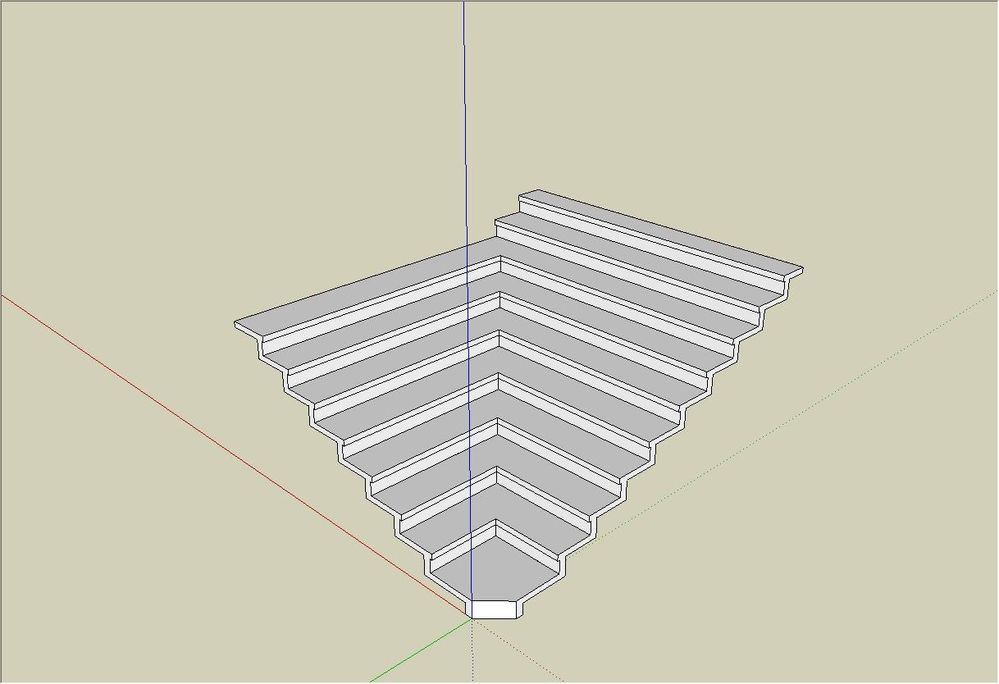

in pic 3, i have to connect these two, but i have differnent number od seats
This one is modeled in sketchup

since you are attempting a special kind of stair, maybe you could look at 'building' it from smaller components the way it might be in reality?
. . . or you could do it very easily with slabs or complex wall profiles . . .
using the stair tool is often a spectacular waste of time in all but the simplest of circumstances . . .

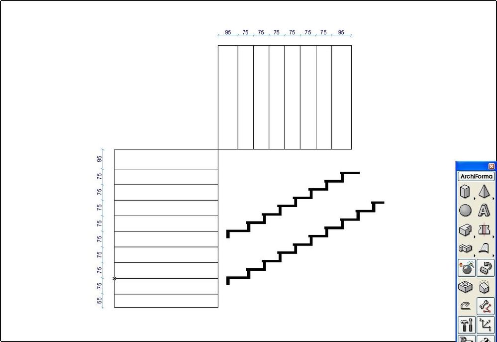

Did it, with archiforma
Thx for tip !
With Profil-Manager
