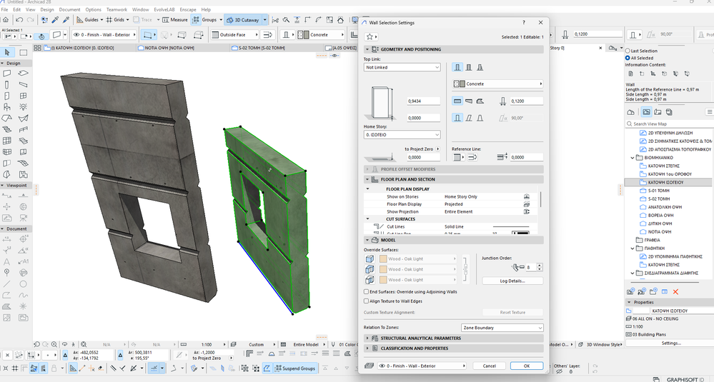

Hi everyone, I found this wall in a client's file and I can't work out how it can exist.
It is a Basic wall, yet its geometry is fully dynamic and freely adjustable.
How can someone create a wall like this without using a Complex Profile or Solid Element Operations, while keeping it a Basic wall? I don't know how the client built it, so any ideas would be greatly appreciated!

Take a look at the Log Details menu.
https://help.graphisoft.com/AC/28/INT/_AC28_Help/040_ElementsVB/040_ElementsVB-17.htm

Could also be achieved via SEO's but there is no icon indicating that those were used in that wall in your 3d snapshot with the wall selected.
4 weeks ago
Wow! Thanx guys! I really wonder how such a tool can exist and yet not offer a little more detail. I mean, couldn’t a wall have vertical grooves like these, or could you assign a specific profile to those grooves? I design industrial steel buildings with cladding panels. If I could use the panel profile as part of the wall itself, that would be really interesting and useful.
4 weeks ago
It is a very old solution literally made for log wall houses.
I think it was around even before complex profiles and has become obsolete and pretty much forgotten since complex profiles have become so popular.
I think some may still be using it - I never have other than experimentally.
