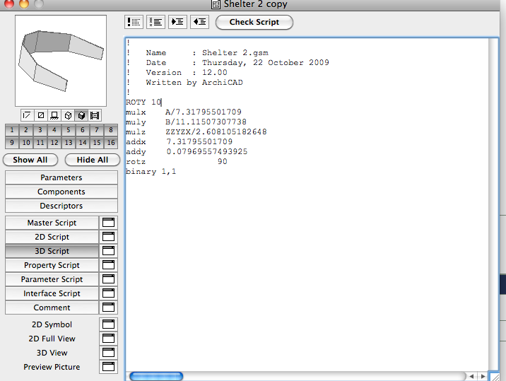

To add the lines in the object, go to File / Libraries and Objects / Open Object. Then you will see the code of the object. Click the 2D script to add PROJECT2 3,270,1 at the top of the script and click 3D Script to add ROTY 10 (rotatie in Y direction ten degrees). The rotator probably does no more than this script.

After I have added to the scripts, what do I do.happens next. I don't see anything change.
EDIT: I changed the ' preview' view point and I can see that it has been rotated. Now what do I do in terms of adding several objects to create the whole face ?

Once I have changed the script what do I do ? ( attached is a screenshot of what I see ).

Ops Sorry,
