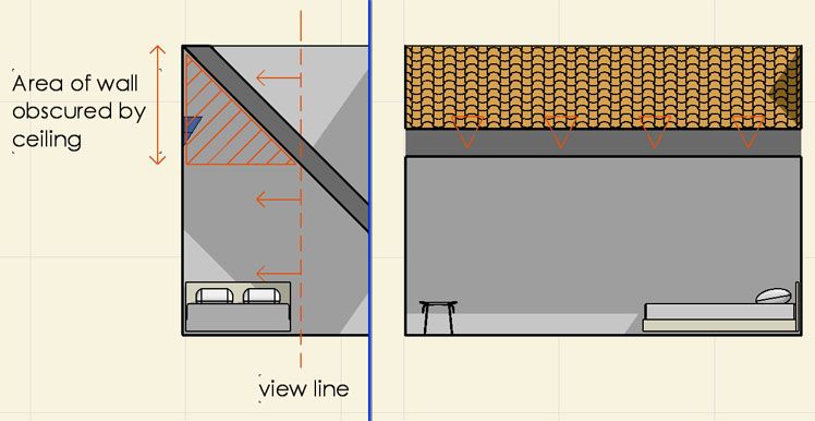

One more comment/wish if GS reads this -
Another situation that it doesn't deal with well is when the position of the cutline means that part of the sloping ceiling obscures the top portion of the wall, hiding any detail that may be there.
The image below is exaggerated, but you get what I mean.
It would be useful if the 'Exclude view blocking walls' setting applied to blocking roofs too.
