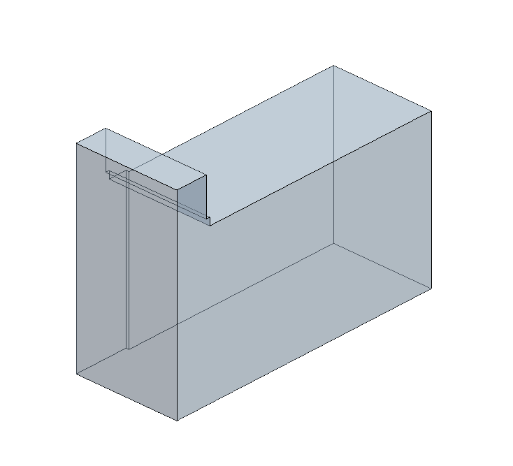

Craig Bagley
And the Zone as trimmed:
AC27 USA/Build 5030 16" MBP

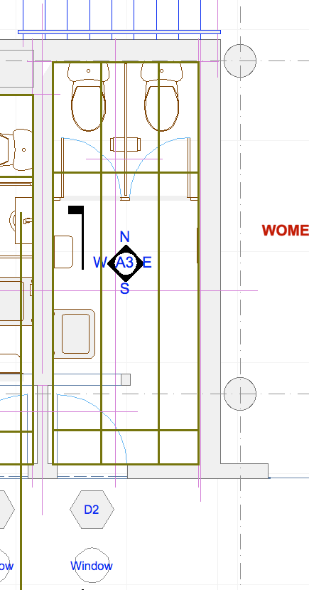

I have 2 additional questions:
1. Who did you achieve this shape for the Zone: did you Trim it by a Roof or did you use SEO? If SEO, do you have the Consider Solid Operations checkbox checked in the IE Settings Dialog?
2. Where are the Interior Elevation Lines? Could you turn on the View\On-Screen View Options\Marker Range toggle and post another image of the Floor Plan View?
The Zone was trimmed to a Slab (dropped ceiling) as well as a number of elements to make up the gap between the lower and higher ceiling (two beams and a slab).
New screenshot below:
From the image I do not see anything wrong with the IE lines or anything.
So it is possible you created a scenario that AC cannot correctly handle.
I suggest that you report this as a possible bug to your local reseller.
