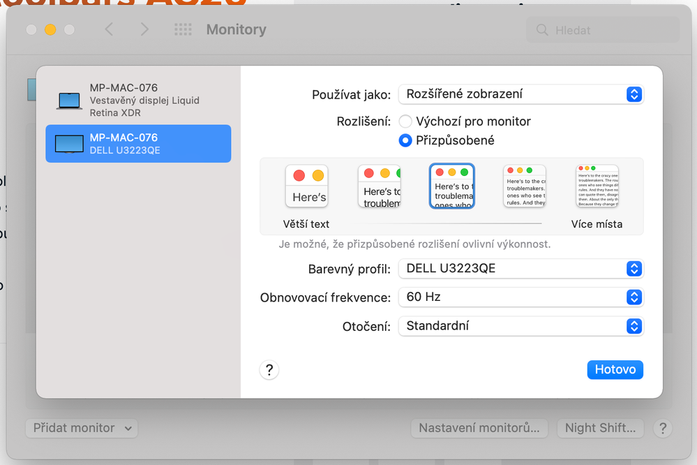

In monitors settings in the system setting on your Mac you can choose the scaling of your 4K monitor. It will change the size of all ellements, includin icons. You can set it independently from your built-in display.Snímek obrazovky 2022-08-05 v 13.05.26.png

Yes, this is what I am doing now.  But why did I pay for a 4K monitor when I can only use it as a 2K monitor?
