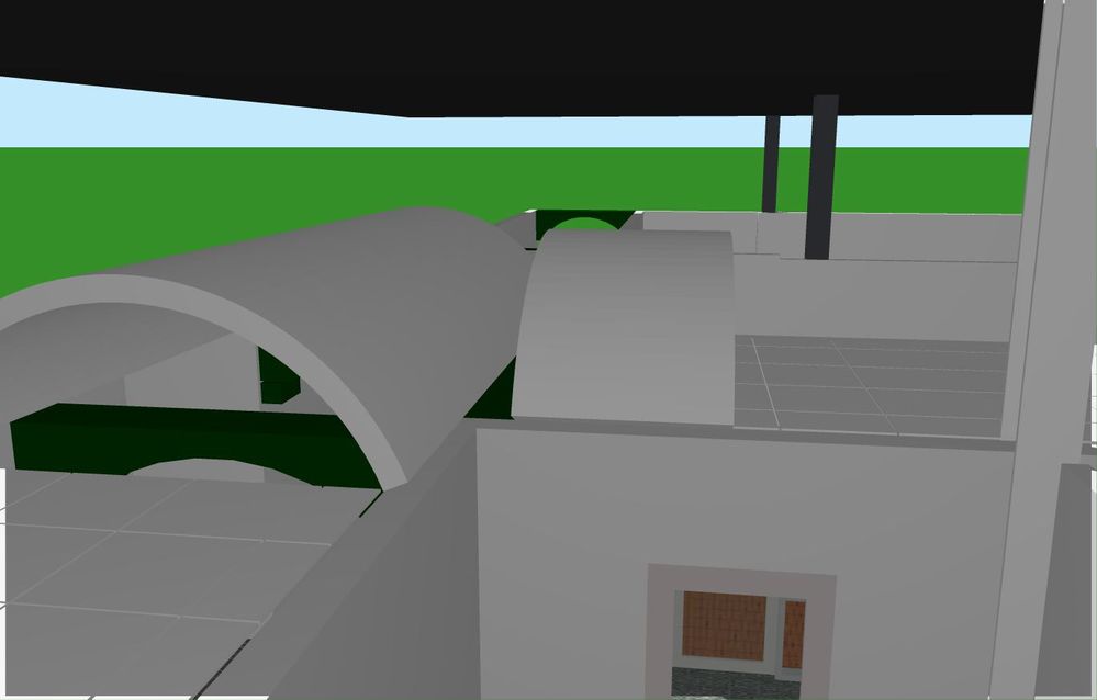

i have two vaulted ceiling but not sure on how get them to intersect

Djordje wrote:
Link wrote:
Can't you just select the entire main vault and ctrl/cmd click the edges of the other vault?
No, but trimming along a known intersection line is OK, as long as you don't care about the roof edges angle.
Only CTRL clicking each of the intersecting toof planes gives the correct result, as does the Composite profile approach - then it is probably a beam or a wall, not a roof ...
It should work to connect the roofs, just not to remove the unneccesary parts.
