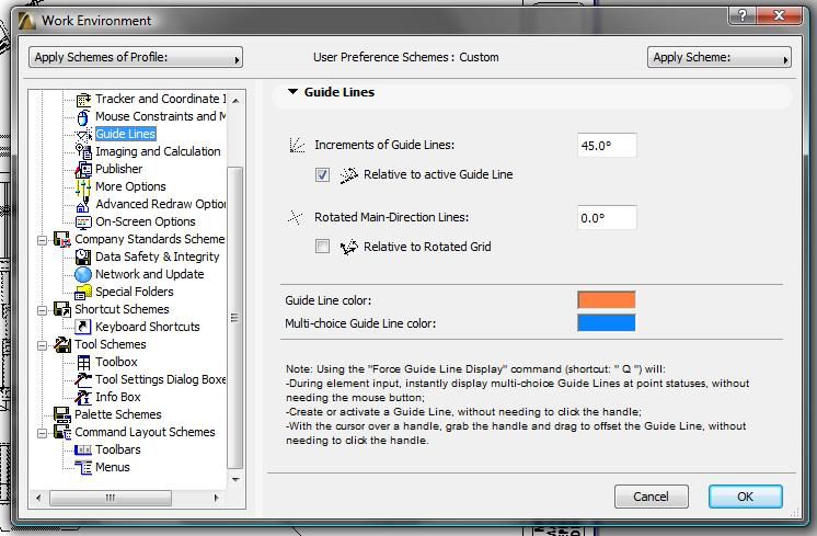

Is there a way to cycle through the protractor orientation?
Trying to rotate a morph element off the z axis and when I get the rotation protractor on the half point it jumps to the x and y axis for a horizontal rotation...Ugh

Options -> Work Environment -> Guide Lines -> Increments of Guide Line:

I made a screen shot of my settings - see below.

Jonathan wrote:
When trying to find the center of the morph element that I wanted to rotate into an inclined barrel vault the half point mark did not appear and the protractor would only indicate a horizontal rotation when placed on the bottom edge of the morph.
If the mid point does not show up, try the Special Snap Point constraint to create it on the fly.
Jonathan wrote:
We should be able to see the half point and the protractor should cycle through the x,y & z axes when placing the curser on that point.
During the rotation edit, you can right-click to get the context menu to get to the Editing Plane > Pick Plane command to select the plane of rotation.
