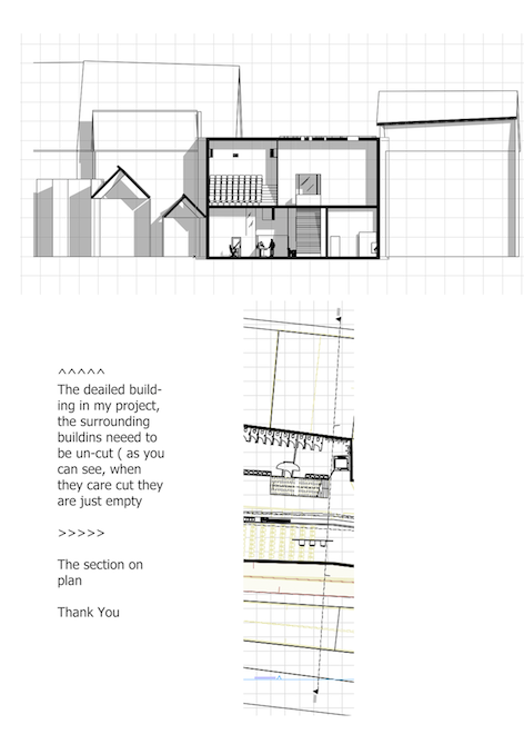

I have a building that I'm working on for a Uni project. I have drawn surrounding buildings that are just very simple boxes with roofs basically.
In section view, I want the main building to be cut but surrounding buildings not to be cut at all ( if this makes sense ) whilst still being able to view all buildings in one section view. The reasons is, I don't need to see inside the other buildings ( as they are empty ), only the main building ( that I've designed ) but I also need to keep them al in the same section.
See the attached for a view of what I mean ( I know the roofs are messed up, I didn't have time to do them correctly, but they will be soon ! )
Thank You this is very important to me !

Stagger your section cut.

Can I stagger a section cut that has already been created ?
The manual shows that you select straight or staggered line before making the cut...
Thank You
Yes. Select the Section line, pick and drag the centre node and use the top-left button on the pet palette that pops up.

When I do that, I can only move it about the centre of the line... How can I change that ?
EDIT: Never mind, I found that you can alter it by dragging it...
