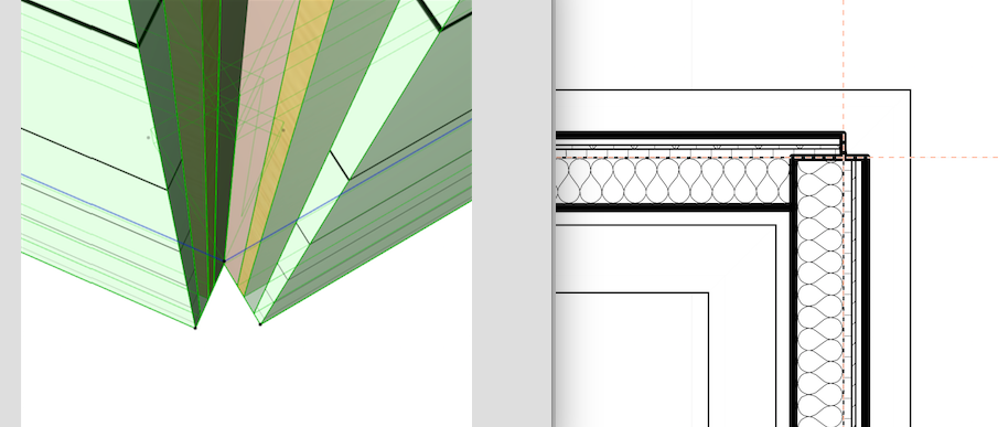

So, I'm new to building walls with complex profiles and having trouble getting them to behave nicely in plan/3d. The endpoints are coincident and the walls are on the same layer.
What should I be looking for in the solution? Any help or direction is appreciated. Thanks.
2 Replies 2
You should change the intersection code for this walls and update the current layer combination, i think.
Excellent - thank you! That did the trick.
