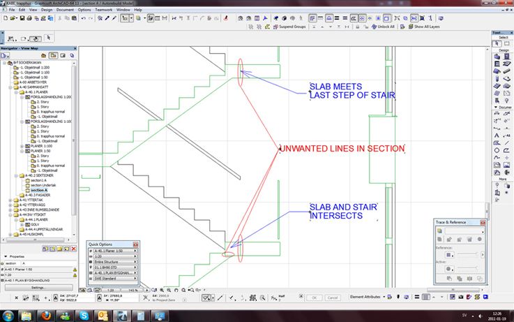

How dp I connnect/join a stair with a slab in section(similar to the way walls-slabs join in section)
The attached screenshot shows a very simple straight stair and I marked the unwanted lines.

One thing to check is that the Cut Fill of the Stair and Slab are identical in name.

If the Stair and the Slab have the same section fill then they will join.
Maybe you did not place the Stair accurately enough.
If you zoom in very closely to those areas you will see if that is the case.
Yes, my error was in different the cut fills.
