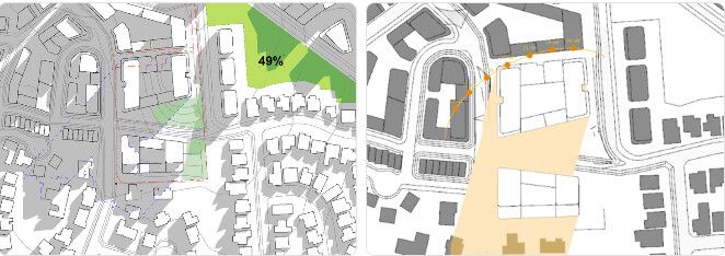

after doing shadow analysis in ladybug and archicad, I see the deviation (~10°) between these results. I dont know which standard and algorthm that archicad uses and which one is more precise?
both use the same model (export from archicad), set up same location, north axis.

I used the same model for both, same location position, same timezone, north axis etc..
Sorry that I can not upload the file (.pln or .3dm) based on confidental of my office. Please just have a look at the screenshot above.

The same model may not mean the same location, time and date in each software.
In Archicad you must set the north point. longitude & latitude, date & time to get the correct shadows.
I am not sure that these are transferred with the model.
I don't know anything about Ladybug, but I am wondering if you have to set those same values there as well.

Can you compare the altitude and azimuth of the sun between Archicad and Ladybug for a few specific date/times.
I would cross reference them against same online sun angle calculators to see if one (or both) are different.
I presume there is a defacto formula that exists for calculating sun angles based on a specific long/lat.
