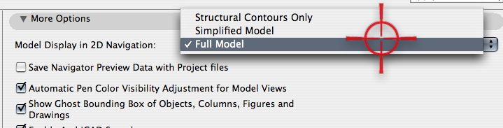

I've never received a report of purely 2D elements (text, etc.) causing a performance problem. (Those 2D elements that are projected from 3D elements are another matter.) Have you or anyone else had seen text cause a performance problem (on a current computer)?
Fair Enough, and me neither, but they've gone to the bother of a dialog box for decreased 2D rendering quality for a reason - OpenGL hits its redraw ceiling and voom: jerky and slow.
I admit to speculating. Has anyone had a drawing failure because of linework, symbol and text size overloading? I have many objects (with buzzillions of line segments in the symbol) that cause quite a slowdown in redraw.....
Dwight Atkinson
