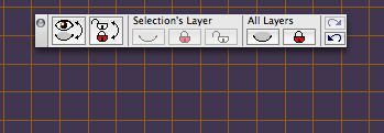

Dwight
It seems that if you use the lock/unlock button it NOT layer specific.
That is the 2nd from left.
Test it out.

Dwight
When i click "Quick Layers" I get this palette
