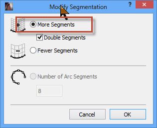

And I try to pull out the ( attach ) interface from AC 18 . Could you direct me ?
Not sure I understand what you want here.
If you just want to find the command then select your morph then DESIGN menu > MODIFY MORPH > MODIFY SEGMENTATION.
Or turn on the Morph tool bar and select the icon there.
You must have the morph selected otherwise this command is not active (greyed out).
