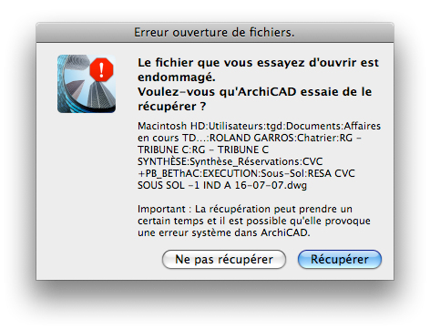

tdeschaumes
For me Archicad 11(1086) is not compatible with Leopard.
I have many problems with dwg files.
A new dialog appear when I try to attach an xref (sea attached file).
I hope that graphisoft will correct these problems quickly, while, I return to v10.4 !
