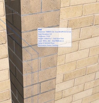

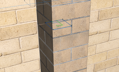

The magnetic selection is toggled on (yes I use space for toggle etc) and for the life of working on AC its been fine
Im not sure how long ago but it started feeling flakey...like its clicking through objects and selecting things behind it when previously, I would simply click on a face of an object...? Any ideas
My defaults for the last many years
Cant see the cursor but it is hovering on a flat face yet still highlighting behind
Selecting elements behind face
Weird
