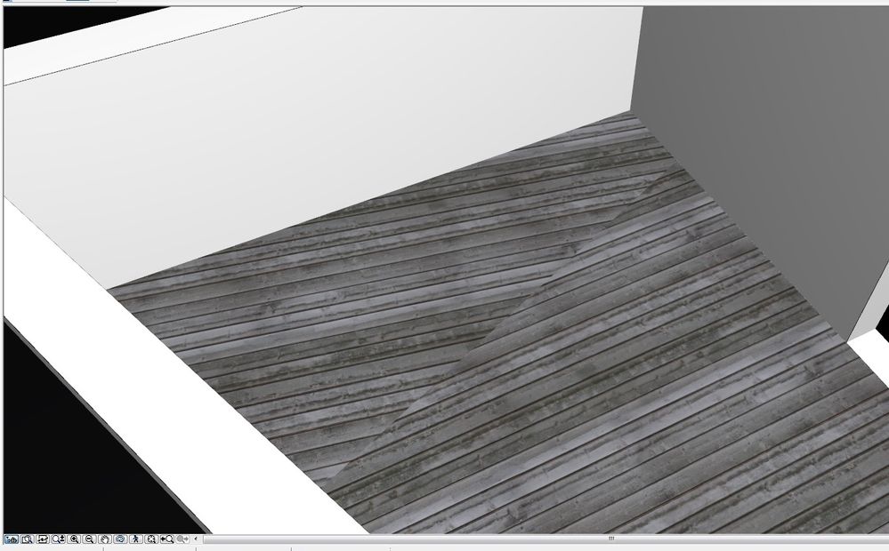

I am sure this is a simple one, but could someone please tell me how to change the direction of a material to view correctly in 3d? See attached screen grab.

In the 3D window use the Align 3D Texture option

Brilliant stuff ejrolon! Thanks again!
