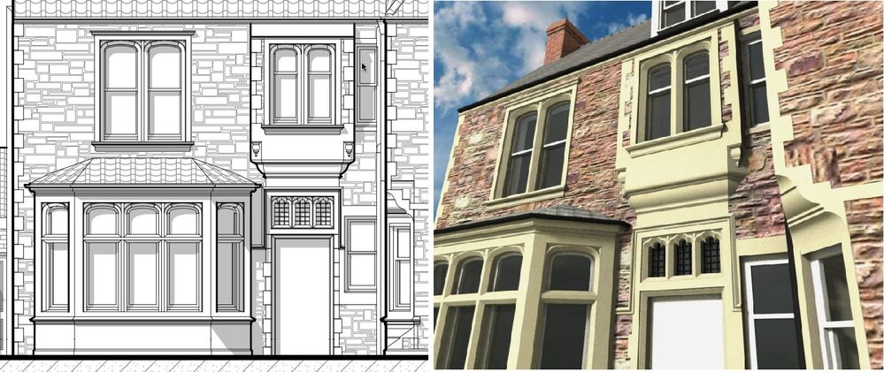

Take a look at OBJECTiVE. It's perfect for modelling details like this, allowing you to profile, bend, rotate, and cut in 3D. You can model details like this directly in a section/elevation window too, and it can be used with all versions of ArchiCAD from 8.1 to 12. The attached example image shows an elevation and render modelled using OBJECTIVE. The elevation is almost entirely generated by ArchiCAD, with a bit of weighted line-work overlaid to liven it up a bit.
You can find out more at: http://www.encina.co.uk/objective.html
There is also an example video clip showing how some of the example image was modelled (about half-way through the clip I think): http://www.encina.co.uk/obj_bend_movie.html

Wow, this is nice. Will it show up in plan, also?
Anything modelled with OBJECTiVE appears in plan as it would look in the 3D window (if you looked straight down on it).
