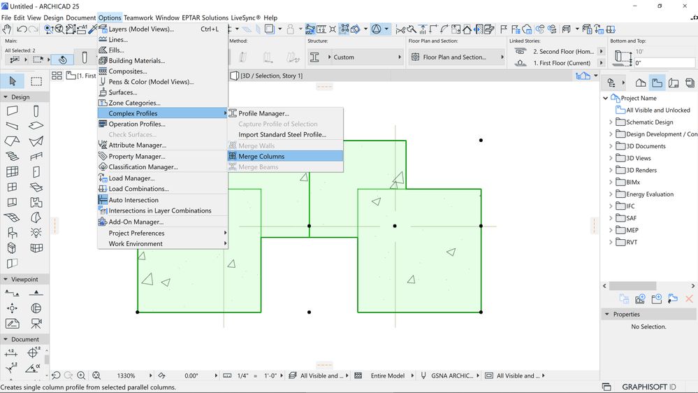

Is it still possible to merge columns in Archicad 25? I can't find this option anymore.

Option >>> Complex Profiles >>> Merge Columns

Edit >>> Reshape >>> Merge columns 😊

@Barry Kelly It is not possible anymore, and I don't know why. Please take a look at the enclosed screenshot.
As @mija illustrated it below, the merging column option disappears in Archicad 25.

This option did not change in Archicad 25 (maybe you were thiking of something else?). Merge columns was always like this. This option makes custom profile for the shape and it can't be complex like yours picture.
I suggest you make it with complex structure in column settings.

Even for simple columns, it doesn't work.
