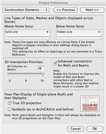

I have a mesh in my model with my building. The site covers (3) stories and I need them to show on all stories for presentation. My problem is that the mesh shows correctly on the home story with the lines solid. But on the story above and below the lines show as dashed. Is there a place to change this setting? I have tried to adjust the floor plan cut plane but no luck in the line work changing.

Make sure elements display a Solid Line Above Home Story and Below Home Story (see attached). Options > Project Preferences > Construction Elements... These are global project settings, so if you don't want this to apply to all construction elements, you can alway overlay a Drawing of each floor plan with a Drawing of the site in the Layout Book.

Thanks Laura. I was in a rush yesterday and had a brain laspe. I did eventually locate the setting. Thanks for the input
