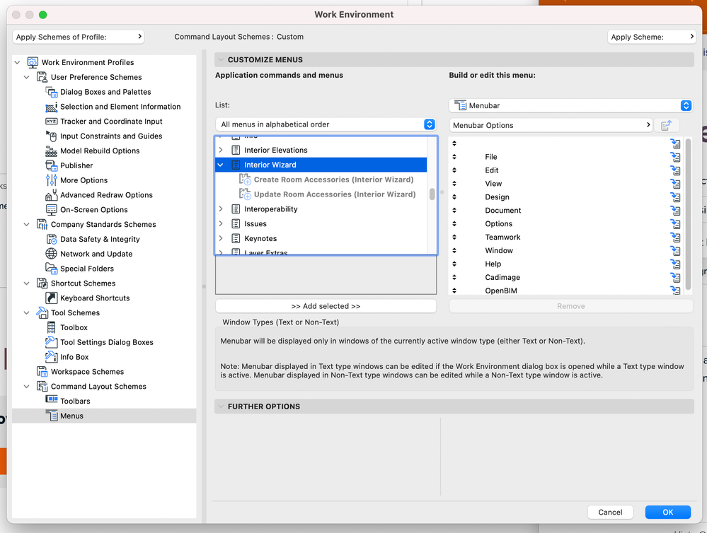

Hi, I am running Archicad 22 and have re-downloaded the Arch 22 Goodies /restarted but I am getting this message when I try to use the Ceiling Accessory... I tried a previously suggested manual installation thru Work Environment but its not available on there either... can anyone please help?  I get message that the Arch 22 Goodies are already installed...

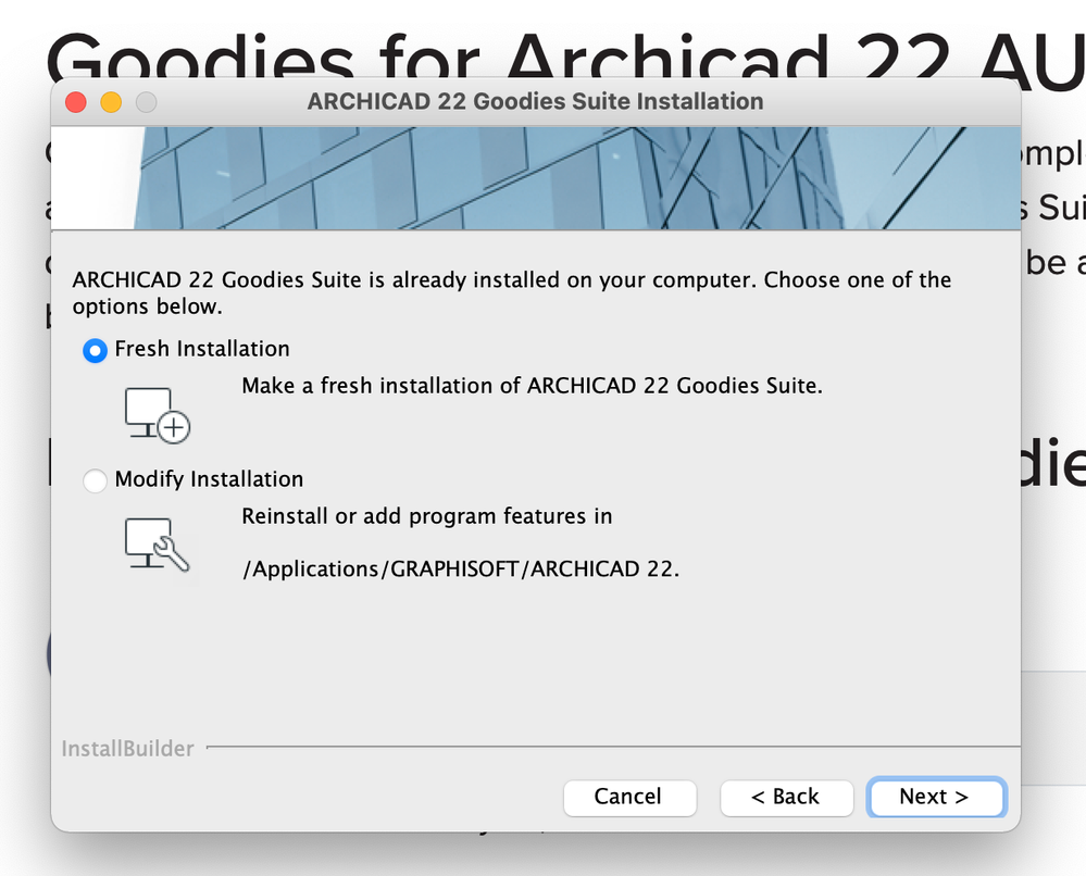

Thank you Barry - would I have to delete the existing Accessories Goodie for the new to be installed as it keeps telling me it is already installed....
I get this message when I try and install it again - when I proceed with Fresh Installation it tells me its already there...

If you already have the goodies installed, you don't need to do it again.
All you need to do is load the accessories library with your library manager.
It will be somewhere in the applications/graphisoft/archicad 22.

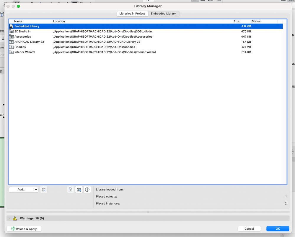

Hi Barry, I have done that but it still keeps telling me it isn't available - now getting this message... thank you so much for your help!

I am not a Mac user and I have never seen this accessories dialogue before.
Not that this is important here.

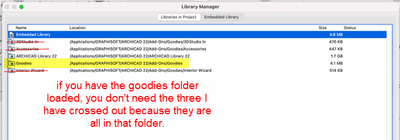

If you are loading the 'Goodies' folder in your library, you don't need to load these other three that I have crossed out - because they are all located inside the goodies folder - so you are simply loading the twice.
Still that is not the issue here.
I don't think the accessories library is located in the goodies folder.
In fact I don't think there is any need to load the goodies folder in your library manager at all.
I am pretty sure the accessories installation creates a library folder of its own.
I am sure there is an 'accessories library' folder located in the 'applications/graphisoft/archicad 22' folder.
That is the library folder you need to load.
I found this old image in an old post.
It is for version 16 but the same applies to 22.
There will be a separate 'Accessories Library' folder that you need to load.
Or move it into the main library folder and it will load the the other main libraries.
YES!! I have success.. thank you so much for you help, I was almost at the point of giving up on it.
