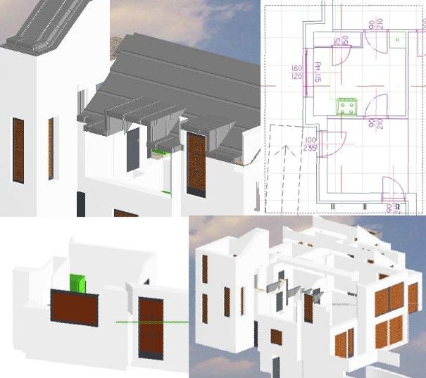

I have serious problems in 3D.
After doing some solid element operations (mostly subtractions), Walls, Slabs and Roofs started to miss in various 3D windows. When the missing objects are selected in 2D to check only them, they are shown correctly in 3D. If area selection tool is active, sometimes some of the objects are shown, sometimes not.
The problem only happens in one .pln, the others works work. Layers, objects to be shown in 3D are checked, no 3D sections.
Rolling back solid body operations didn't solve the problem.
ArchiCAD 8.1SE.
1. (upper left) a 3d window, missing walls and slab
2. (upper right) 2d detail of the same part
3. (bottom left img) the same in area selected, walls appear
4. (bottom right) The whole building in 3D. all roofs, slabs and terrain miss. After rebuilding i got the first image: most reappear, some not.
