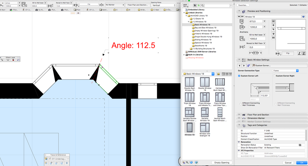

I’m working on a project with bay windows where I can’t use the bay window object, therefore I want to use separate windows and join the corners.
It looks good in 3D, but in plan there is a ”gap” between the windows and I can’t understand why. I’m using the correct angle for the connection, so what might be the problem here?
see screenshot below

Try 67.5° (135° divided in half).
DangCad1
That didn’t work but 135 degrees did! Don’t really understand why since it’s not the right angle but problem solved. Thanks!
AC 28 / Apple M4 Pro 24 GB / OS Tahoe 26.3.1
My bad.
You need to specify the full angle which is 135°.
The end of the window is at 67.5°.
