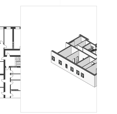

Hi, I have an issue and I bet the fix is really easy.
When I try to get a 3d Model view onto my layout the border crops the model. When i change the border to be bigger the model doesn't show completely.
I tried a lot of stuff and couldn't figure out how to get the model to show fully. Let me know if you have an Idea 🙂
Thank you In advance!

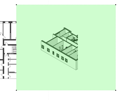

Sadly have the same issue with all views.
Im loading the 3D window with an isometric view into the layout.
I tried rebuilding the model and it didn't work.
The view gets loaded into the layout cropped like that and even if I move the model in the layout it doesn't load the rest. 
Thanks for your efforts :)!

I got It!
I had to redifine the 3d window with the current view settings.
Thanks for answering 🙂
