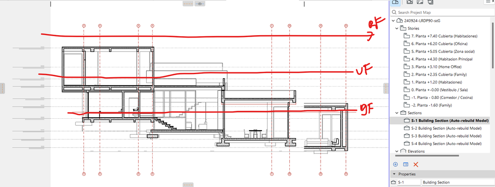

I have found in this project that the structural engineer has provided 10 different levels to organize the different floor slabs of the project. It is a complex project due to the terrain. The thing is, from an architectural perspective, I would only handle 3 levels: the ground floor, the upper floor, and the roof. However, I am unsure of the best way to define them, as for the ground floor, as seen in the section, there is no line that captures all the spaces properly. How would you resolve this?

I would make ground floor the one where the sectioned stair begins. That way you can look up or down no more than 1.5m aparently and it will display correctly.
upper floor and roof look ok. make sure slabs are in the correct level, even if your lowest upper slab is quite near to your highest ground slab.
you could also add a couple of levels but then you would have to stitch some layouts together so it displays correctly.   its a little bit of a hassle at first, but once done it works really fine and gives more control (and of course, if you change your plans You would have to adjust the viewports accordingly).

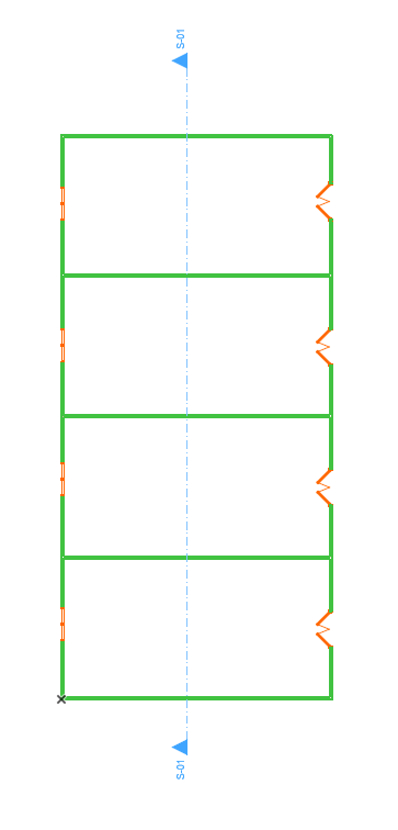

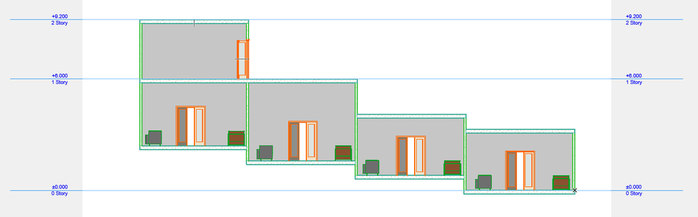

I handle this situation as @Lingwisyer suggested, by setting some GF walls (which Bases are above the level of cutting plane, here = 1.10) to be displayed as Symbolic Cut.
- Don't forget to set those 2 structural slabs in a hidden layer while working on floor plan, you can use (Gravity to slab) to handle placing your furniture easily.
Edit: this solution is available for basic & composite walls as they can be displayed as a symbolic cut and not available for the complex profiled wall as it doesn’t have a symbolic cut display option.
