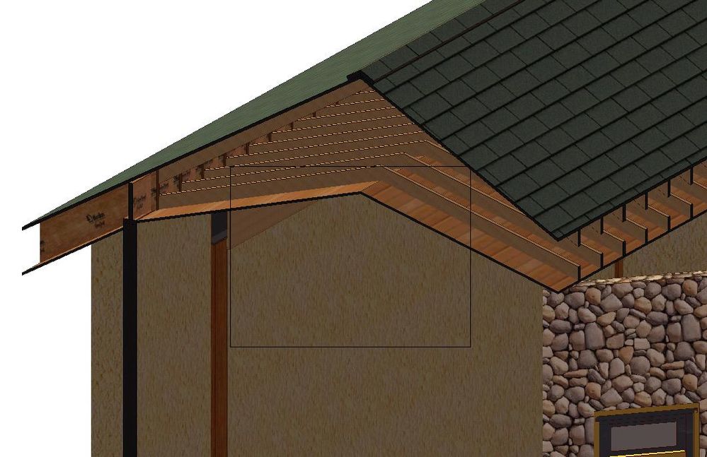

As far as the modeling Trusses question, I use the (not using AC10 yet) the AC "TrussPro" Object. There are no webs and I do not model them. In the Section views that show the truss I use the Polyline tool to "fake" the webs. I group the polylines for ease of copying & pasting to another Section view.
My one problem with the truss modeling is discussed here.
Also a truss discussion is here.
I will attach a few of my "going Nuts" with the Model.
Roof Rafters
The Fascia is made from little Roofs. Kind of a pain.
Here is a Section view with the Fake 2D polylines representing webs. Often not the True truss web either just a representation.
