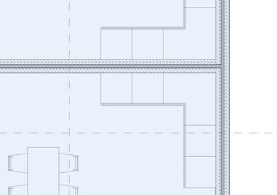

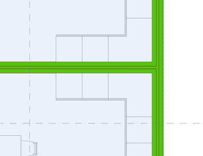

Hello everyone,
I have built my multi-layer walls with individual wall components, as I could not do it any other way. See attached photo. My problem now is that I only want to output the outer contours, without the inner contours. See photos in the attachment.
I hope that someone can help me.
Best regards

There are different ways to achieve this by the use of Graphic Overrides or by creating a composite wall that doesn’t show the internal wall skin separating lines or cut fills.
This official video may help you get started by creating a plain composite wall material that has no cut fills assigned to it. Then use that composite to create a plain wall with the thickness you have above.
https://www.youtube.com/watch?v=YtQ-8TXRUVM
This is one way to do it.
