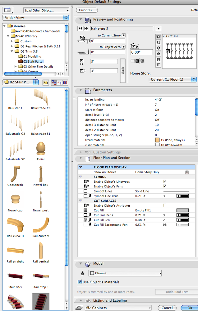

I don't detail stairs to the level talked about, and find Stairmaker, as bad as it is, generally gets the job done. However, if you do want to build them piece by piece, SmartParts has a pretty good object list available. I don't really use it, as above, but it would be easier than making everything.
