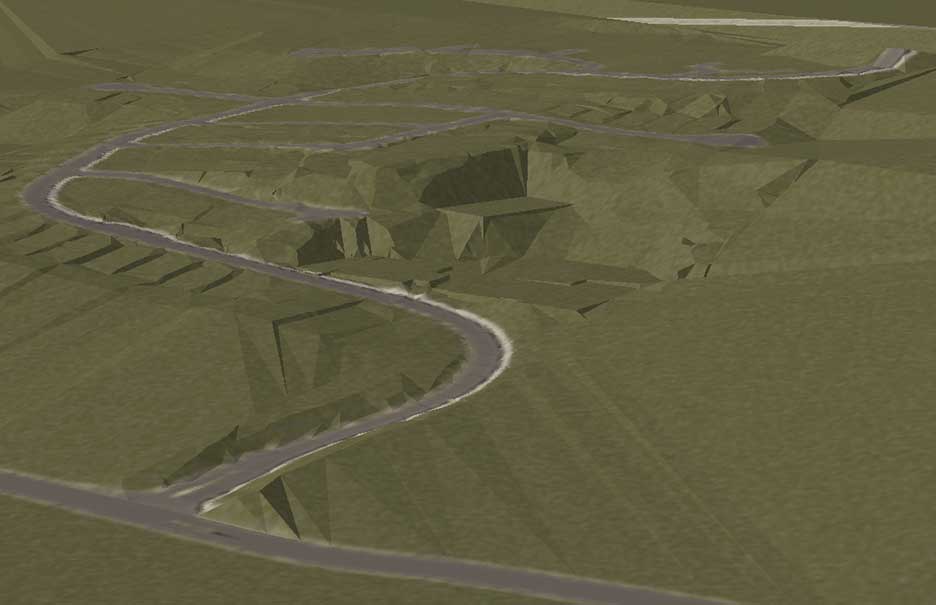

I now need to create different surface textures around the landscape. Is there a way of doing this?
My colleague suggested I split up the mesh so it had different sections and therefore could have different surface textures. So I have used the 'split' tool but this will only split the mesh in two. I also copied and pasted the mesh to create a jigsaw puzzle of various pieces, however this messes up the levels at the intersections and requires a very timely re-leveling of all the nodes.
Surely there must be an easy way to draw around the landscaping sections and split up the mesh?!

You CAN use the add-on "ArchiTerra," but the easy and free way is to make one large bitmap of your entire site with the differing elements drawn on.
Make this bitmap as a material texture to the correct size.
Use the 3D Align tool to make the bitmap material image repeat link to a corner of the site.
Attached is an example of a contoured site with the roads and sidewalks drawn on the surface bitmap.

Dwight
That's a well-worn technique.
The surprising aspect is that Archicad can map a large area with one image instead of repeating many small ones.
Beginners will have difficulty aligning the texture using the 3D Align Tool since large texture images don't always show in OpenGL.
For beginners. the lower left corner of the site should fall on the origin - 0,0 to meet the starting image repeat interval.
