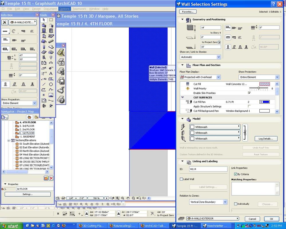

I set the cut section fills in my exterior walls and all columns to a custom hatch pattern that is basically the same as structural concrete, and initially all was well - it was showing up fine in plan and section.
Then I started poking around in the default views and layout book settings, and discovered that the walls and floors default to a solid fill in those views. OK, no problem, I figured I can just define my own views if I decide I don't want it that way.
However, the next time I went back into my model, in the project map view, I found that all of those hatches had been changed to the solid fill in the model itself! The fill pattern still shows in the object settings, but what's showing up on screen is a solid mass of color, not the fill hatch pattern. Even walls that I did *not* assign any sort of fill to (just empty fills) are now showing up as solid masses of color, even though they still say they are empty fills!
What's going on here, and how can I fix it, and keep it fixed so this doesn't happen again?

It looks like you have toggled Bitmap fills on. Check that View>On-screen View Options > Vectorial Hatching is turned on (it will look indented).
Could also be that you've altered the appearance of (cut) fills in your Model View Options, which are assigned to your views. Check those at Document > Set Model View > Model View Options...
Cheers,
Link.
How might I have done that? I didn't do anything to mess with the fills, at least not that I know of.
Yup, it's on. It's been on the whole time I've worked on this project.
Again, how might I have done that? I didn't go into these sections at all.
Well, thanks anyways, Link. I don't know what I did, but a little while ago, after some more general mucking about, the fills all suddenly flipped back to the way they're supposed to be. If it happens again, I'll take another look at these possibilities. At least it gives me a place to start looking, so thanks for your help.

Model View Option Combinations are assigned to views, so all you needed to do was double click on a view (in the View Map) that had a different Model View Option Combination assigned to it. There's no mystery, try double-clicking on different views and see what happens.
