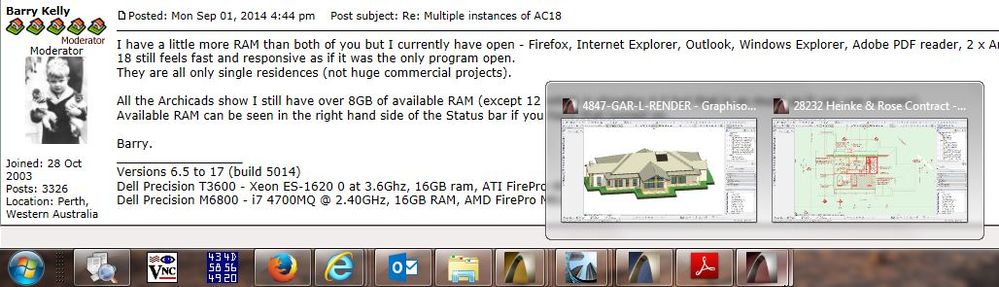

I have a little more RAM than both of you but I currently have open - Firefox, Internet Explorer, Outlook, Windows Explorer, Adobe PDF reader, 2 x Archicad 18, 3 x Archicad 17, 1 x Archicad 15 and 2 by Archicad 12 just for good measure.
18 still feels fast and responsive as if it was the only program open.
They are all only single residences (not huge commercial projects).
All the Archicads show I still have over 8GB of available RAM (except 12 which is showing 4.0 but that is as much as it can use anyway).
Available RAM can be seen in the right hand side of the Status bar if you have that turned on.
Just to show they are all running at once and you can see the type of projects open in all versions.
