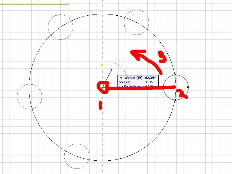

this morning i got it to work for the first time... yippeee.
So.
1. the drew a big circle.
2. then i drew a small circle on the bigger circle line.
3. selected the small circle and clicked MOVEMENT - MULTIPLY
4. selected rotate.
5. back on plan, i drew a line from the centre of the big circle to the centre of my little circle.
6. then moved the new circles around 360.
see graphic below.
Ian
