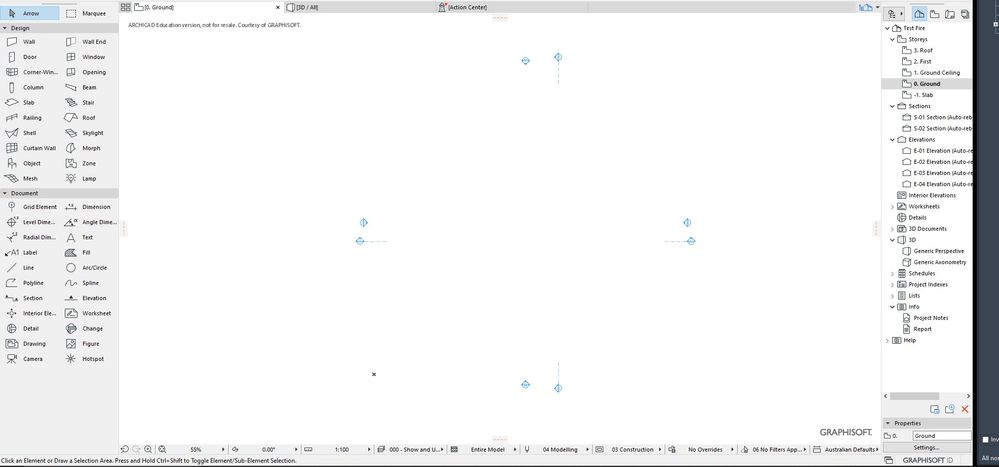

I've created a slab and then when I navigate to ground floor I couldn't find the slab that I've created. How can I be able to see the slab I created in the ground floor??
Below is the SS of the slab I've created.
Just for your information, I just downloaded the software yesterday and using it today
AC24 EDU.

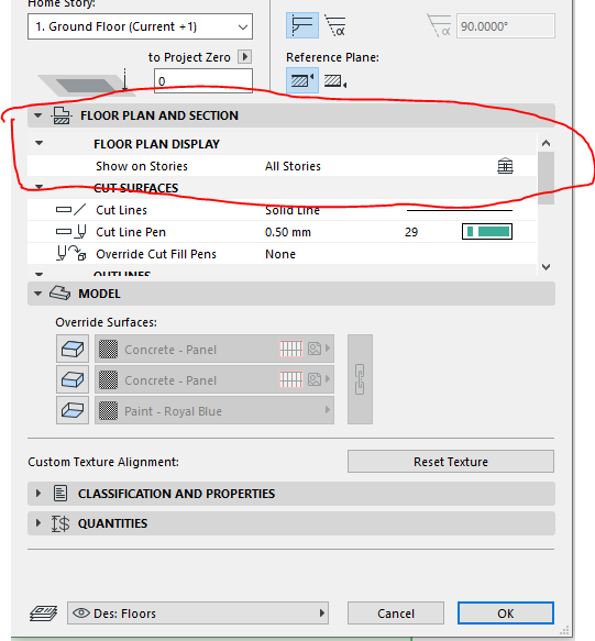

There are many ways to see other plans in different stories:
1. Select slab and Ctrl+T, change Floor Plan Display to all stories, you can select and edit the slab in all stories this way.
2. Use Trace, by this way the plans from a different story is only a reference, you can't edit or select them.

Albert Belesi
It worked.
Thank you very much.
