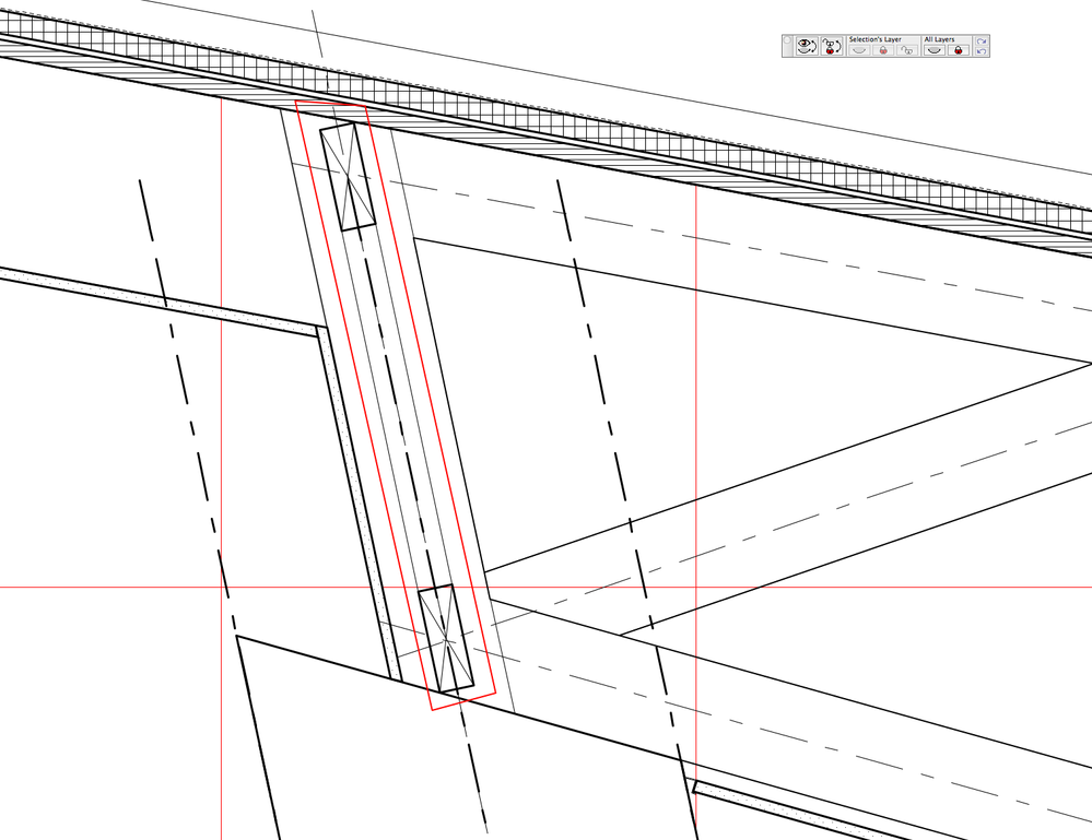

I'm making some trusses using truss maker, and I was wondering if it is possible to make a truss that is leaning so that it is not completely vertical. It doesn't seem like it's possible to just make a vertical truss and then rotate it in section
Thanks!

This can be done a number of ways. The easiest might be to turn them into a morph and then rotate the morph.
